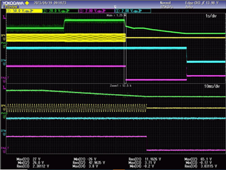

Currently my design consists of 2 level PVDD for TAS5634 which is 40V and 58V (change based on vol level). Fault happen when the PVDD switch from 58V to 40V. may i know is there any limitation when there is a voltage change in PVDD?
HI,
Below is the signal that captured during fault goes low. when the PVDD drops, it trigger the fault goes low. the speaker output signal seems normal at that time.
green:PVDD
yellow:speaker output BTL config(1KHZ playback).
light blue: OTW
pink: fault

So, I think it may be triggered UVP in your application.
Maybe GVDD and VDD dropped with PVDD drop.
You can confirm the voltage waveforms of VDD and GVDD when the PVDD voltage is dropped.

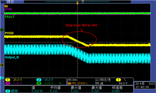

Hi Mototw.
Sorry to reply you late.
My test result as below, test condition: BTL 6Ohm(One channel), 73W output.
CH1 is FAULT, CH2 is OTW, CH3 is OUTPUT_N, CH4 is PVDD.
I still can't reproduce your problem.
Maybe you can find if there are some place different from your side.
