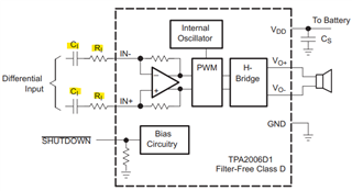

  • Hi Nir,
    Looking at your schematic I noticed the input gain setting resistors are missing. Can you try modifying your circuit such that you have R at the inputs instead of capacitors? You may replace C2 and C6 with resistors temporarily just to test this.
    Here's a circuit reference from data sheet:
    -Ivan Salazar

  • Thank you Ivan,
    I understand that R2 can not serve as a gain setting resistor since it is "behind" the C2 capacitor?
    Also, what value would you recommend the gain resistors should be set to?
    Nir.
  • Nir,
    Correct, being the resistor behind the capacitor it does not work as gain setting resistor. Please notice you need the same resistor/capacitor on both inverting and non-inverting inputs, regardless of using differential or single-ended input.
    As for the resistor value, you may try 300k or 150k to keep the gain low for now.
