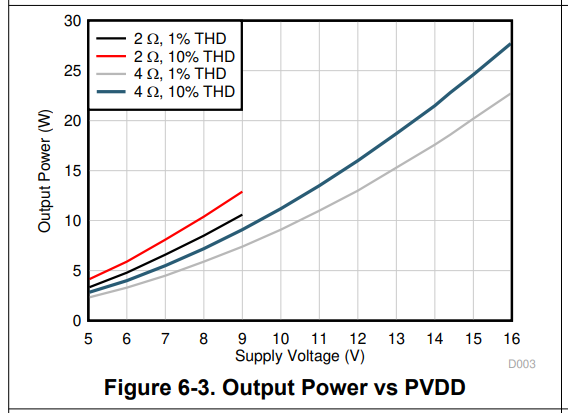

Hi team,
Can you please share the Output Power vs PVDD curve like below from TAS5441-Q1? Or can customer just use below curve but with output power <8W?
Hi team,
Hi PY,
You are correct. The customer can use the same graph but limit the power to about 10 W into 4 ohms, and 6W into 2 ohms. These limitations are caused by the lower current shutdown on the TAS5431-Q1.
