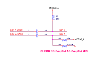

1.  Could you help check the PCM6260 schematic , and any need to adjust

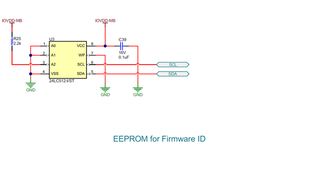

2 . The EVM line of pcm6260 has I2C and EEPROM on it. Could you please help me to confirm this function? Is it necessary to use it? Do you need specific software? If necessary, can you provide the file?

    1. Is this design required to support   DC coupling?

    3. Where is the E2PROM you refer to? The PCM6240 does not require any EPROM for its operation
  • Hi Sanjay
    1.Since the MIC part has not yet been determined, the customer is to reserve both the AC & DC settings. Use BOM to change later, the default should be DC.

  • The PCM6240 does not need any E2PROM . It can be directly conigured over i2cBUS.
    AC Coupling: Place 1U Coupling Capacitors
                          Place 4k7 Pullups t MicBias
                          Remove 1k Pulldown
    DC Coupling Differential
                             Remove 4k7 Pullups to MicBias
                            1u coupling capacitors are replaced by 0 ohm resistors.
                             Remove 1k Pulldown
    DC Couplng Single Ended:
                             1k pulldown is made 0 ohm
                               1u coupling capacitors are replaced by 0 ohm resistor on InP Pin
