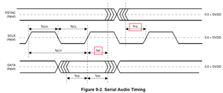

How to understand tSF and tFS, would you pls give an example, thanks!
would you pls help give an actual example(what's the actual points on waveform, ) for these parameter, thanks!
Please see the description and specification on page 11 of the datasheet.

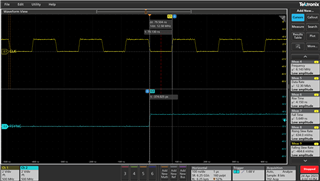

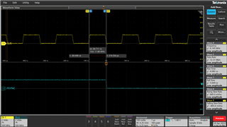

Hello, pls help to give a illustration, thanks! also, pls help to check below waveform is right or not?
tFS:
tSF:
Hi Liujian
Your waveform seems no problem. The key to this two parameter, is to change the LRCLK level at the point of falling edge of SCLK, which is the most standard using. Using this way, you needn't to worry about this two parameter any more.
Hello Shadow,
thanks for you reply! but still not understand very clearly, "LRCLK" means "FSYNC"? you mean "FSYNC" level change(low-->high or high-->low) should at the point of falling edge of SCLK, right?
how to understand 8ns? thanks!
Hi Liujian
Yes, FSYNC and LRCLK are the same things, it has different name from different literature.
Yes, that is the standard using.
That is the minimum time digital side used to guarantee clock safety. The rising edge is the effective point in SCLK, when FSYNC need to change, the flip position need to be far away from the rising edge of SCLK.
