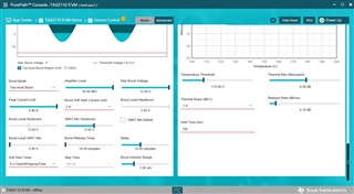

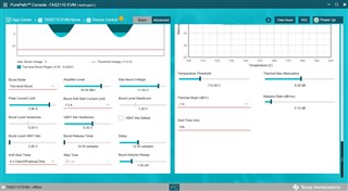

Hi Team,
VBST cannot Boost to 11V,
Please help check circuit and PPC3 GUI setting and Register Hex file.
Vbatt level: During 4.3V
Booster voltage setting: 4.3V
load: 2ohm
target output level: 2W

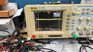

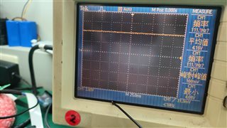

  • Hi~lvan,
    We used one cell battery for 4.1V and capture of the VBST/PVDD as below picture.
    When we input the audio source maxmum it still never to enable the boost and always keep the volage 4.16V.
    And we listening to the sound that output have clipping.
    We want to know how to set the PCC3 parameter setting is correct.
    We wish boost the voltage to 11V and output power of 5W/4 ohm.

  • Hi Kevin,
    Can you try the following:
    • Configure the boost to "Always On" mode
    • Make sure noise gate feature is not enabled
    • Use the scope to inspect PVDD/VBST voltage, set the trigger at some level higher than VBAT eg. 5.V, configure the scope to capture a single trigger sequence
    • Power up the device
    • Check if the scope captures a transient of PVDD/VBST rising higher than VBAT
    This way we can at least know if the boost is being able to power up initially and it's later on being disabled.

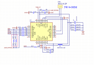

  • Hi Ivan,
    Maybe schematics have something wrong, Due to TAS2110EVM boost function is OK, But EVT board also cannot boost, SW pin waveform is not stable.
    In the TAS2110EVM User's Guide Figure 10. TAS2110 schematics device, not meet Table 3. Bill of Materials corresponding part value, would you help confirm this issue?
  • Hi Kevin,
    The BOM may have been incorrectly copied from a similar EVM. I'll double check on the proper BOM and share it by tomorrow.
    As for the boost operation, SW is the switching pin of the integrated boost, so it should not be a regulated DC signal. Could you clarify what you mean by TAS2110EVM boost function is OK, but EVT board cannot boost? Are these two different PCBs? Is EVT a custom board different than EVM?
    Some important things to consider in the layout for proper boost operation are listed below:
    • DREG capacitor should be placed close to the IC
    • GREG capacitor should be connected to PVDD pin in a star connection, ie. directly to the pin instead of connected to a plane or polygon close to the decoupling capacitors
    • PVDD and VBST should be connected outside of the IC, not below it. Each of these pins should have its own decoupling capacitors.
    • TAS2563 QFN version is similar to TAS2110, you can refer to those same guidelines: https://www.ti.com/lit/an/slaa988a/slaa988a.pdf
