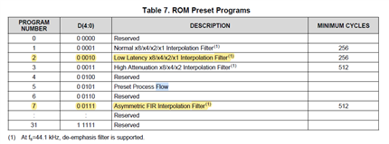

when I test the PCM5121EVM the delay time is not match with the datasheet descprition.
in datasheet the 0x02 preset flow delay time is 3.5/fs, when fs=48K, but the AP actual test DUT delay time result is 104.3us.
the 0x07 preset flow is 1.2/fs, when fs=48K, but the AP actual test result is 125.0us.

    There may be a confusion on the settings for Page 0 Register 43, here some details:
    • There are 4 different filter settings for the interpolation filter, below is a capture of the different mentions of these in the data sheet:
    • The lowest filter group delay is the Asymmetric FIR, which configuration is 00111 on Page 0 Register 43 bits 4:0.
    • Notice this is the delay of the interpolation filter itself, other processing blocks would add to this.

    my test result turn out very strange result,the  Asymmetric FIR(0x07) is not the lowest delay about 125us. while the low latency flow(0x02) is the lowest delay about 104us.
    can you help to confirm if the test result is correct? below is my configuration setup:
