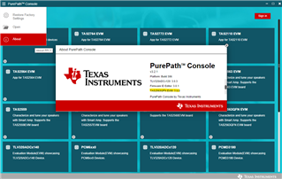

  • Hi Mochizuki,
    Could you please share a capture of the "About" dialog within PPC3? You should be using TAS2563QFN EVM:
    Please share the customer email address used for their myTI account, you can share through private e2e message or email. Then we can check if they have the proper software access.
    -Ivan Salazar

  • Hi Ivan,
    I posted our customer email address to private e2e message.

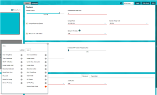

     3. Is there System check function on TAS2563QFN EVM plug in GUI? Previous TAS2563 EVM plug in has that function.
    Also there is no IRQ tab on TAS2563QFN EVM plug in, how can we see IRQ live status?
    Mochizuki

    Regarding the IRQ flags, you can see these at the "Device Control" panel, at the top-right corner, this shows a pop-up window where you can inspect both latched and live interrupts.
