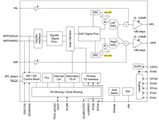

How  can I dynamically control the output volume on a TLV320DAC3203 (HPL HPR) with digital mics as input?
The datasheet says:
"The level of the DAC signal can be controlled using the digital volume control of the DAC. To control the output-voltage swing of headphone drivers, the digital volume control provides a range of –6.0dB to +29.0dB (1) in steps of 1dB. These level controls are not meant to be used as dynamic volume control, but more to set output levels during initial device configuration. Refer to for recommendations for using headphone volume control for achieving 0dB gain through the DAC channel with various configurations."
But I cannot see those recommendations anywhere.

  • Hi Gustavo,
    The data sheet recommendation refers to use the DAC gain configuration, rather than the headphone amplifier gain. I've highlighted these gain control blocks on the diagram below:
    You should use Page 0 Register 0x41 and 0x42 for each of these gain controls: www.ti.com/.../slau434a.pdf
    -Ivan Salazar

  • Hi Gustavo,
    Thanks for your comments, I actually noticed a couple things I have to edit on my previous post, and adding further details on your questions below:
    • Based on the description, you should actually use the driver gain as fixed value, and user the DAC filter for dynamic adjustment. (Opposite as my initial description, sorry about that confusion)
    • DAC gain offers a couple advantageous features:
      • Soft-stepping can be used to gradually adjust the gain, even when setting new gain value with a considerable difference. This feature is controlled by Page 0 Register 63. Page 1 Register 20 is a different feature.
      • DAC volume for Left and Right channels can be tied together, this way you can control the gain of both channels with a single register write. This is controlled by Page 0 Register 64.
    I'll make edits on the previous post to show the correct information.
    -Ivan Salazar
    Applications Engineer
