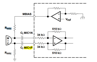

    What is the role of the capacitor (Ci) connected to MIC1N and MIC1P?

    In the circuit below, MIC1P is connected to GND via Rmic. Is there any problem if MIC1N is connected to GND?

    Ci is a input coupling capacitor. Its purpose is to remove DC offset from the input signal, including MBIAS
    We have an app note that explains what to consider when choosing coupling capacitors: https://www.ti.com/lit/an/slyt796a/slyt796a.pdf?ts=1693927774082&ref_url=https%253A%252F%252Fwww.google.com%252F
    Did you mean to ask if MIC1P is connected to GND? MIC1P is tied to GND through Rmic so that the impedance is balanced on both the positive and negative side of the mic terminals. If you mean to tie MIC1N to GND as an unused input, that is fine as long as Ci is in series with GND.
    In the datasheet it is the 'P side' of MIC1, but is it problematic to connect the 'N side' of MIC1 to GND via Rmic?

    Since the amplifier is differential, then there is no issue connecting N side of MIC1 to GND via Rmic.

    There is no functional difference between connecting MIC1N to GND and MIC1P to GND, is there? If MIC1N is connected to GND, then MBIAS is connected to the MIC1P, correct?

    The capacitors only purpose here is to absorb the DC offset. The capacitor will form a high pass filter with the input impedance. The fully differential impedance is 60kOhm so each side sees 30kOhm. With a 0.22uF coupling cap, this has a cut off of 24Hz which is pretty normal considering the audio band starts at 20Hz. If the capacitance were to drop to 0.11uF the cut off raises to 48Hz.
    As long as the capacitor forms a desired high pass filter while the 2.5V MICBIAS is applied, then there is nothing to worry about.
    For your second question, yes. The amp is differential so the only consequence is a 180 degree phase shift.

    2. There is no information on Rmic in the datasheet except for Figure 12: Rmic is pulled up on MBIAS and pulled down on GND for the inputs of the differential amplifier, can you tell us what it is used for?

    2) The Rmic are pull up/down resistors for the mic, not the amplifier. The coupling capacitors separate the two. The Rmic to MICBIAS is to power the microphone. The Rmic to GND is because a differential mic will typically bias both sides so that they match in amplitude. This resistor value is typically the same output impedance of the microphone in order to maximize power delivery. 2.2kOhm is a common choice for this bias resistors.

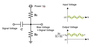

    Is it correct to understand that the meaning of the above is to propagate the waveform above 0V by adding the Bias voltage as shown in the figure below?

    Q1) From a filtering point of view, yes the filter is unnecessary since the digital filters will take care of it. However that capacitor is relevant to Q2
    Q2) You are correct, the effect of the bias will be that the signal raises above 0V. That's why the coupling capacitor is important, so that the signal returns to 0V.

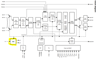

    What is the MUX (analog switch) of TLV320AIC1110 used for? Is it okay to leave unused processing open?

    1) Can you be more specific? Pin# or Register#? I'm not sure which MUX you are referring to.
    Sorry, MUX meant the following. I would like to know about the intended use and how to handle of unused pin.
    Conor
  • Hi Conor,
    Thank you for the clarification. It's an analog mux to allow an analog input signal to pass through to different loads. If it's unused I would ground the input pin and leave the outputs floating.

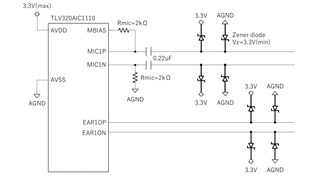

    I am considering mounting an external zener diode for overvoltage protection on the analogue inputs and outputs (MIC1P/N, EAR1OP/N) of the TLV320AIC1110, I plan to use a component with Vz=3.3V (min), is this a problem?

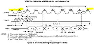

    In Data Sheet Figure 1 and Figure 2, is there any problem with PCMCLK continuing to be output before 0 and after N+1?

    Is it correct to understand that the PCMO goes Hi-Z at a minimum of 30ns after the falling edge of the Nth bit clock, as in tpd3 in Figure 1?
    The following statement is found in the power-on initialisation section of the data sheet.
    'In addition to resetting the power down bit in the power control register, loss of MCLK (no transition detected)
    automatically enters the device into a power-down state with PCMO in a high impedance state."
    Will the PCMO be Hi-Z in states other than the power-down state described above?

    1) Yes this is fine,

    4) PCMCLK should run continuously. 0 and N+1 are just markers to show how the MSB and LSB aligns within the transmit time slot.
    5) Yes you are correct. Without a subsequent PCMSYNC trigger the output will go to high-z
