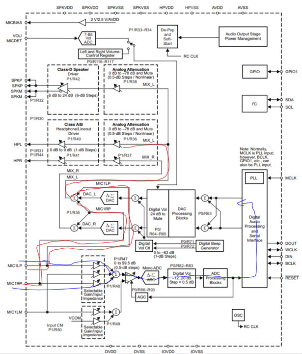

In my design stereo signals from Radio IC (Single-ended) uses MIC1LP and MIC1RP inputs for headphone or speaker output.
1-LP and RP unite at ADC. Also, LP RP unites directly after the DAC without any conversion operation so is this the way to get analog output?
2-Is MIC1LM passes through DAC after ADC?

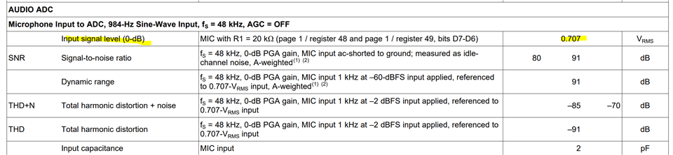

3-Radio Chip is supplied with 5V so can I connect signals directly or do I need to change the voltage level?
