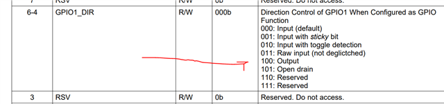

The datasheet indicates an input current of 10ua at a logic level of High.
This may be infered as an equicalent pin impedance of 3/10ua or 300k.
In general we have not really seen reports of device failure with GPIO pins being open.
However if the customer desires they can configure the unused GPIO pins as outputs . This makes the pin low impedance.
