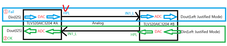

TLV320AIC3204: I2S 24bit "DAC" is inoperative.
Part Number: TLV320AIC3204
② #B to #A is normal.
① The voice received by Din(I2S 24bit) passes through the DAC and is not heard from the HPL. Is there anything I set wrong in the register below?
The register below is the register of #A.
The register of #B differs only by "0x1BC0".
(length of Audio Interface LJF - 16bit)
I couldn't hear the sound from HPL of #A, so I didn't check the ADC operation of #B.

  • Hello.
    #A standpoint
    IN1_L(Analog) -> ADC (I2S, 24bit) -> Dout (normal)
    Din -> DAC (I2S, 24bit) -> HPL (failed)
    I don't know if I understood your request correctly.
    I'm writing again as I understand.
    For #A, I2S, 24 bits is fixed (44.1kzh, 48khz, 96khz, 16bit)
    For #B, LJF, 16 bits is fixed (32khz, 16bit)

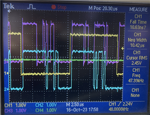

    I deleted all the comments and left only the actual registers.
    Operated as SPI, TLV320AIC3204 is in Slave Mode.
    In the case of I2S, the external device is Master.
    MCLK, BCLK, and WCLK are also supplied from external devices.
    TLV320AIC3204 is a slave.
    #A Oscilloscope
    1CH (Yellow): WCLK
    2CH (Sky Blue): Din
    3CH (Purple): Dout

  • Can you check if AVDD is present and what's the voltage? How do you provide DIN and what's the HP load?
    The register looks ok see my comment in the attached file.
