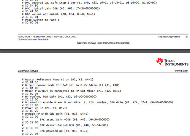

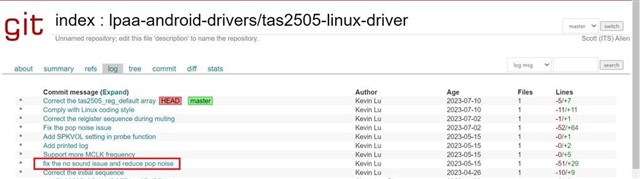

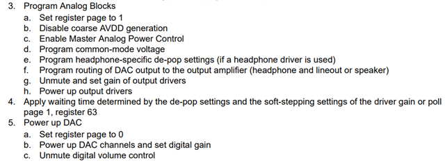

Hi Team,
My customer is experiencing intermittent no sound issue with TAS2505; they suspect the issue is with their driver code.
I already recommended them to look at one of the recent update of the driver. Is there more detailed explanation (change-by-change or line-by-line comments) on the changes made?
That will definitely help identifying the problem.
