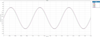

when we measured the 1kHz sinewave output, found one channel has phase shift compare to other channels, how would this happen? and if have any register can setting this inside TAS6424E?

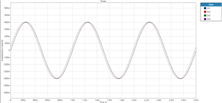

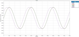

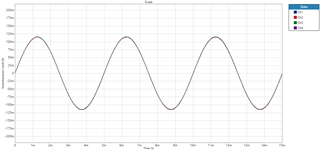

    for the LC value, what we used is L=3.3uH, C=1uF, and now we found another phenomenon, as below show:
    the phase shift absolute time between two channels seems the same whatever output frequency change or not, what's the reason here? thanks!
    200Hz                                                                                     1KHz
    5KHz                                                                                        10KHz
  • Hi Liujian
      Could this phenomenon reproduced on the EVM? Please let us know what is your input signal format, and your register settings about it. We could have a try at our side. If not able to reproduce, this delay possible coming from input directly, seems happens to be one Fs cycle.
