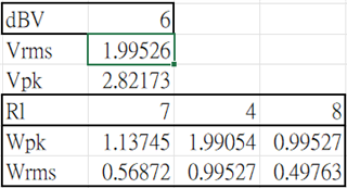

  • Hi Hill,
    Some more information, I've calculated the RMS and Peak output power for each case, RMS is slightly over the mentioned value for 7ohm, and Peak value is over the mentioned value, please check on the speaker specification.
    You can refer to the attached file, modify the dBV value from the limiter.
    dBV 8.5
    Vrms 2.660725
    Vpk 3.762833
    Rl 7 4 8
    Wpk 2.022702 3.539729 1.769864
    Wrms 1.011351 1.769864 0.884932
    TPA2028D1_dBVtoW.xlsx
    -Ivan Salazar
    Applications Engineer
  • Thanks for sharing more information. For more details about our speaker specifications, it has a 4 ohm with 2W (and 3W maximum) and a 7 ohm with a power of 1W (and 1.2W maximum).
    so if I understand correctly, for a 4 ohm/2W speaker I should set the limiter level at 7.5dBV,
    and for 7 ohm/ 1w speaker at 6dBV right?
  • Hi Hill,
    That looks correct.
    -Ivan Salazar
