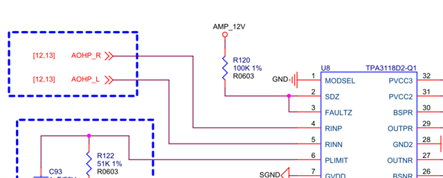

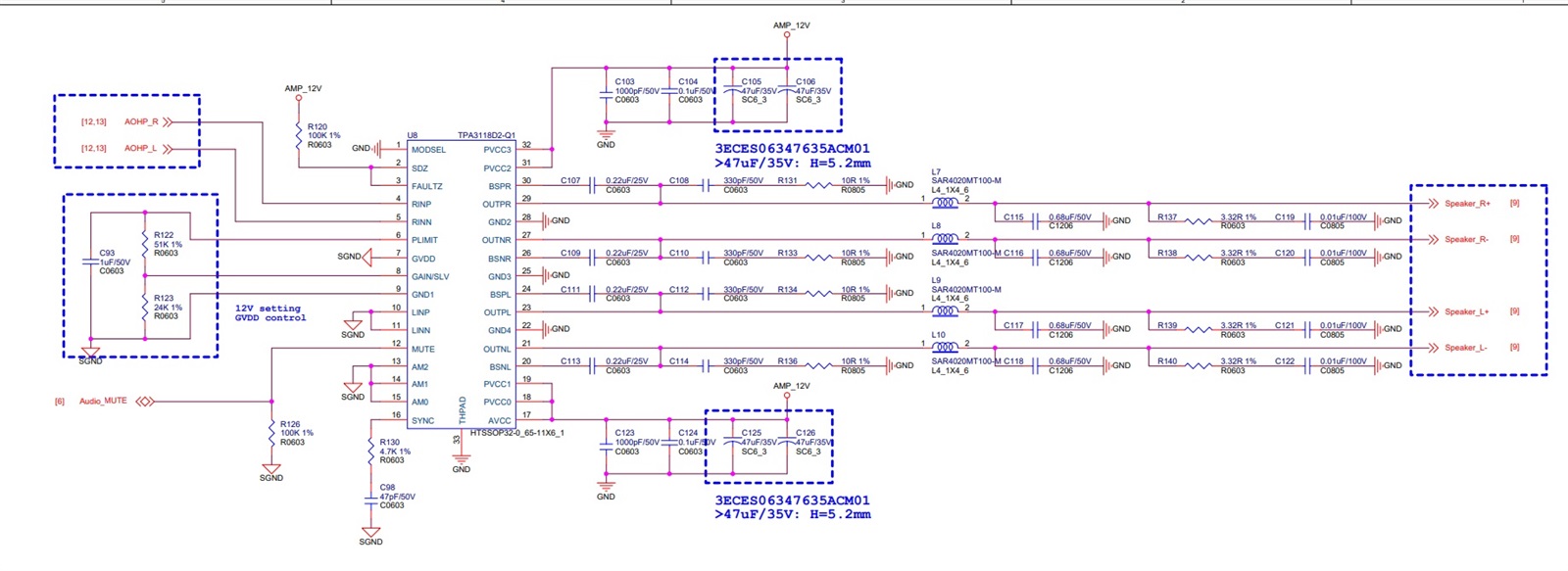

Would you please help review below schematic? thanks!
Jeff
Hi Jeff
From the schematic, we are using BTL mode, but INPL and INNL pin all connected to ground, may I ask why?
At INPR and INNR, didn't find the DC block 1uF capacitor. Please make sure we have it, otherwise the device may not able to work.
Hi Shadow,
=> Referring to the attached design, for safety reasons, is there a need to reserve any components?

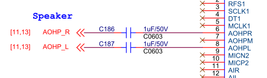

=> BT module(Pin 6,8) speaker output ,connect to TPA3118(Pin 4,5) input.
Jeff
Hi Jeff
No problem about the input capacitor.
Do you mean the left channel needn't be used? That's no problem.
