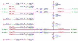

  • Did you mean change to 0.47uF of C7299,C7300,C975,C7039? Right?
    I found out another issue for gain 1,0, we hear louder scratching noise, seem CRB has same issue. Do you have idea to reduce it?
    Yes, those caps change to 0.47uF. And the caps should be put close to AMP. The trace from AMP to caps should be same.

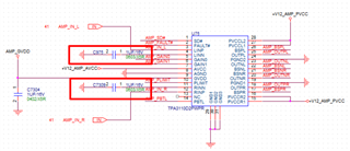

  • Does C978 C976 need to change to together?
    I change caps to 0.47uF of C7299,C7300,C975,C7039,C978,C976 before.
    Total 6 caps, but pop noise is not impact.
    If change to 10uF, pop noise become big.

  • Hi
    Accroding to your description, I think the pop noise is related to audio input. With Gain increasement, pop will increase.
    You can short to audio input to GND through C7299, C7300, and check pop noise again.
    Are C978 C976 required by Codec side? If not, you can reduce the value.

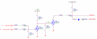

  • Hi
    MB Test
    1. Pop noise.
    I try to change that del R1390/R1392 and add R1395/R1396 to 22K from codec output.
    When I use botton to control SD# enable or Disable, pop noise has occurred.
    Of couse short Amp input to GND, pop has not occurred, but it is not normal work.

    There seems to be a scratching noise present when the amplifier is turned on.
    Did you short audio input to GND through 1uF caps? Do not short input to GND directly.
    If there is no pop when audio intput short to GND through 1uF caps, it means noise is from audio input side, not AMP side.
    Please double check audio input noise!
