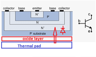

  • Hi Luis.
    Thanks for your support. Got it that thermal pad has to be connected to V-.
    The customer wants to know the potentail issue that might happen by connecting the thermal pad to GND. The already have built the 1st proto with the thermal pad connected to GND. The will plan to change this in the 2nd proto, but wants to continue the evaluation with thermal pad connected to GND for the 1st proto.
    So, my customer wants to know what might happen by connecting the thermal pad to GND.
    Ohashi
  • HI Ohashi-san,
    The thermal pad must be connected to the most negative supply Vs-.  The thermal pad needs to be connected to the most negative supply and not other potential to ensure proper performance.  Almost all modern semiconductor products use p-substrate process to implement the transistor-level circuitry, which require the p-substrate to be biased at the most negative supply voltage used to power the IC. Thus, connecting the thermal pad (located at the back-side of the silicon wafer) to any voltage above (V-) may result in current leakage that increases at the elevated temperature – see image below.
