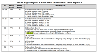

In datasheet of TLV320AIC3101, it describes that in master mode, BCLK can be generated with 32fs or 64fs. But I didn't find the register to configure BCLK. Could u pls help to explain how to get 32fs BCLK in master mode? Thanks!

I believe you are referring to the statement below. This is master in continuous mode and it's giving an example with 16-bit or 32-bit data width.
In continuous mode, only the minimal number of bit clocks needed to transfer the audio data are generated.
You configured either continuous or 256-clock mode in register 9 below.
