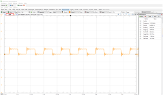

  • Hello again!
    Regarding nr 2, I am sorry but I think I missunderstood. ESP32 I2S should with auto make it mono when choosing only one channel

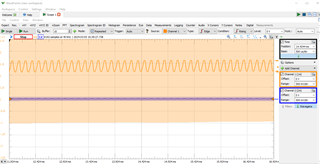

  • Hello again gain!
    I realize that the measurement of the FSYNCH was attrocious so here is a better one
  • Hi Christoffer,
    Thanks for the information.
    From the scope capture, C1 is BCLK and C2 is FSYNC, correct? Can you show a full cycle of C2? I just want to double check it runs 50%duty cycle. Your BCLK frequency is 3.072MHz?
    Regarding the interrupt flags, from register 0x24 it shows TDM clock error. Please make sure that both BCLK and FSYNC are running before enabling the device. Whenever the clocks stop the device goes into shutdown mode.

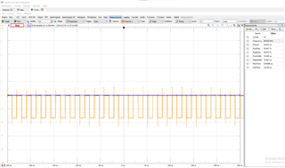

  • Hello hello!
    Regarding the scope capture, I onle showed purely FSYNC (I might have misunderstood and thought you where only interested in that) so yes the orange channel 1 was indeed  FSYNC which has the values on the measurement as C2 aka the FSYNC frequency was measured to be 48002 kHz etc. Here is the scope from purely BCLK which is the orange and also has the measurement as C2
    Which has the frequency of 1.5370 MHz so rougly 50% of the 3.072MHz as you expected
    For the TDM error, I now make sure that the BCLK and FSYNC is going before enabling the amp and that did indeed clear the TDM error, so now the Latched interupts are

    • Disconnect the speaker from the amplifier, and using an oscilloscope check either OUT_P or OUT_N. The output should be a PWM signal. If you connect the speaker back again and retry, is the PWM signal still there?

    1) There is a PWM on the OUT_P/N both with the speaker on and off the board
    2) I just double checked, and there should be nothing on other than what is on the schematic
    3) sadly that had no effect
