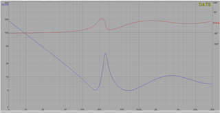

  • Hi Yutong
     An example of impedance curve like below, at DC has very large value because there's internal capacitors. Will make the DC load diag report OL.
    The AC diag is designed to deal with this situation. You could follow datasheet 8.3.5.2, or use PPC3 to quickly have a try.
