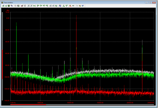

  • Fred,
    Maybe a better idea would be to send you a picture of what I am talking about. Here we are sending the standard digital JTEST for jitter testing. This is an asynchronous Class 1 USB DAC with dual really low jitter Crystek (0.5ps) oscillators going to the Wolfson dac chip and the TAS1020B MCLKI pin for generation of the I2S frames coming out of the TAS1020B.
    The RED is the TPA6130A with the cap coupling, it sits just below the 120dB marker. The WHITE is the direct connect using the 4V regulator for the TPA. The Green is using the National 4.7V regulator, the same kind that is used on the dac chip for the analog output.
    Gordon
  • Hello Gordon:
    I checked the design files and the DC from the DAC plus the input signal may be biasing some of transistors in the input of the device.
    This would account for the degradation with the inputs direct coupled.
    For best performance in your design, I suggest that you use input capacitors.
    If your applicaton requires maximum performance, I suggest that you consider the TPA6120A2.
    Sorry that the news is not better.
    Rgds,
    Fred
