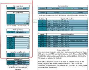

    With MCLK=22.579MHz, you will need to configure the PLL to give 16KHz Fs.
    Here are the steps:
    1. Divide MCLK by 2 using PLL_CLKIN_DIV to give 11.2895MHz
    2. Then, set the respective divider as shown below to get Fs=16KHz.
    You can refer to section 2.7 of this reference document for clock generation/PLL.
    TLV320AIC3262 Applications Reference Guide
