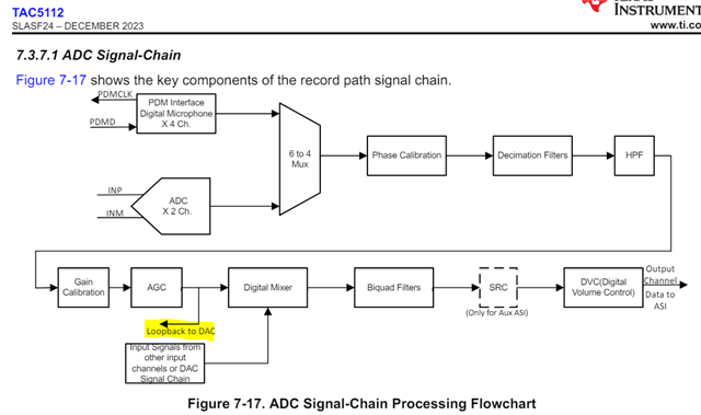

My customer would like to have two audio paths, IN1P/M to OUT1P/M loopback and I2C to OUT1P/M, simultaneously as below. The IN1P/M to OUT1P/M loopback gain is -10dB and the I2C to OUT1P/M gain is 0dB respectively. Is this doable? If yes, could you provide a PPC3 configuration file to meet their requirements, please?

    There is a provision made in PPC3 for this exact routing. Screenshot below:
    The gain will be applied in the DAC signal chain through digital volume control, shown in the screenshot as -10dB gain is applied to signal sourced from IN1M.
    I will update this thread with a script that entails all the registers needed for this configuration to operate correctly asap.

  • Hi Hirano,
    To update, please try the script attached.

    However, first of all, they would also like to confirm what kind of path can be achieved or not.
    Could you show this loopback path in a block diagram such as section 7.3.7.1 ADC Signal-Chain (Figure 7-17) and section 7.3.7.2 DAC Signal-Chain (Figure 7-32) of the TAC5112 data sheet, please?
    K.Hirano
  • Hi Hirano,
    The loopback path is present in the image.

  • Hi Hirano,
    The loopback from the ADC actually occurs after the biquads in the ADC signal chain and the data is inserted following the biquads in the DAC signal chain. I have made a note to revise this in the datasheet. The block following the adder is where the DVOL control takes place.
    Yes the DVOL can be adjusted for outputs independently, an example is shown in the first screenshot.
