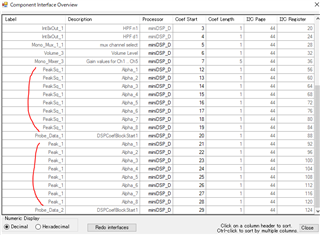

I'm reading the level detector (PeakSq_1 and Peak_1) values ​​with [Debug Probe Point], but the cycle is 0.5 seconds at the fastest.
Q1:
 Is there a way to check the data at a faster cycle (for example, 10 ms cycle)?
 Is it a good way to check the register data directly?
Q2:
 We can check the register address of level detector (PeakSq_1 and Peak_1) in [Component Interface Overview],
 but how fast is the register data update cycle (**ms)?
 For example, is it updated at about a 10 ms cycle?

  • The memory data from the peak detect is updated based on the audio rate but reading it by MCU will depend on the I2C/SPI speed.
    You can speed it up with SPI instead of I2C.
