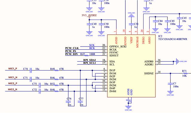

Can you elaborate on wiring 2 analog MEMS microphones with differential output to TLV320ADC6140 in Channel Summation mode?
Should I simply connect the first microphone Differential Output (+) to both IN1P and IN2P in parallel, Differential Output (-) to both IN1M and IN2M in parallel, and the second microphone Differential Output (+) to both IN3P and IN4P in parallel and microphone Differential parallel Output (-) to both IN3M and IN4M in parallel? Of course, I need to activate Summation mode (4--->2).
