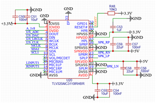

First of all, I want to let you know that I am new to hardware design, so please be gentle. Anyway, I integrated the TLV320AIC3110 into my project, based on the datasheet sample design, and the speaker output works without an issue. However, when I am recording, there is a continuous beep sound. I couldn't follow the suggested layout due to limited space, and I couldn't separate the analog ground and digital ground on my PCB. I placed all the capacitors very close to the codec, but the analog ground and digital ground are mixed.
While debugging, I thought the issue might be related to AVDD power supply noise and separated the AVDD power line from the board, but it didn't work. The system is based on Linux, and I am using kernel driver 6.6.y. I tried many things on the software side, but nothing worked. Could someone help me identify the issue?

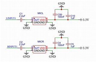

  • Hi, thanks for your help. There are 2.2µF capacitors (as suggested by the microphone manufacturer) on each microphone line, but they are located on another board near the microphones. I checked the PLL clock setting and tried to record at different frequencies, but it didn't help. The recording is working, and I can hear the recorded audio, but there is always a beep sound in the background.

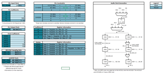

  • Your configuration is not correct, the clock settings are mostly powered down.

    You should configure the clock's divider something like this if the sampling is 48KHz as an example.

    I attempted to remove them one by one, but each driver is linked to many more dependencies. As a result, I can't handle obtaining that data after the module is loaded. I am confident that the driver works and sets the registers as expected. My intuition suggests it might be related to the hardware design. I consulted a friend who is using the same codec with the same Linux driver, and they are not experiencing any issues.
    Could you confirm if my schematic design is correct? I am currently redesigning the PCB and trying to separate AGND and GND, as suggested in the datasheet's layout. Do you have any advice? And also if you let me know how to read registers after loading driver, I can share that data as well. Thanks for your support.
  • From the schematic above, I don't see any issue there.
    I'd suggest the following:
    • disable the MIC1LP/RP connection to the ADC through the register, is the tone present?
    • remove the mic connection and provide a tone to the codec mic1LP/RP inputs, is the recording good?
    Regards.
