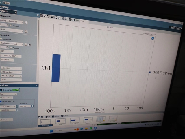

Our microphone project, one transmition and one receiver. The transmition use 5120, 5120 I2S output to telink. The receiver is telink UAC output.
Now we encounter problem.It's when input small signal such 5mvrms, THD+N is below 0.2%.But we see frequency spectrum on ap, the interference
is big,as following picture.According to 5120 datasheet, enable dre will help optimize this problem, write 0x25 data to 0x3c register,write 0x81 data to 0x6d register.
The actual test result is that when input small signal such 500uvrms,the gain is no change.The attachment is 5120 init code.Please help to check and help
resolve the problem.Thank you!

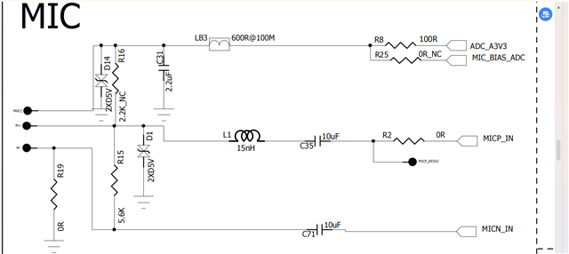

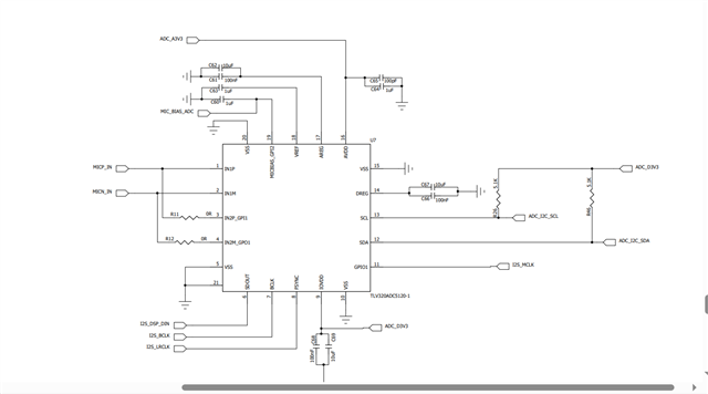

  • OK. Please send me the schematic so that I may co-relate with your code
  • Hello,the attachment is the schematic.Please help check!Thank you so much!
  • Please look my reply.Than you so much!
  • I dont see an AC coupling capacitor in the schematic. The I2C settings indicate AC coupled mode is used. Can you please also send me the complete mic circuit feeding the ADC?

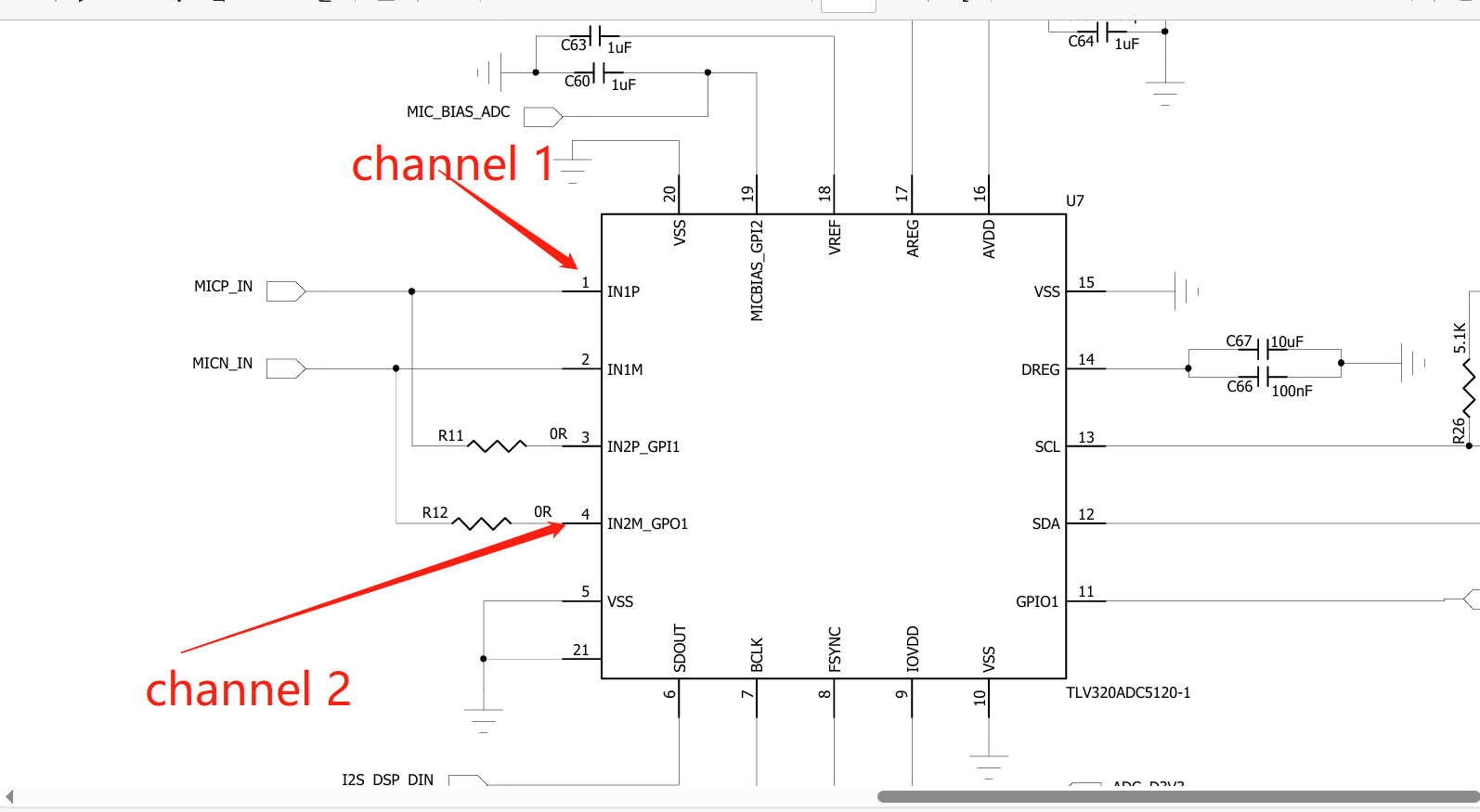

  • 1、MICP_IN, MICN_IN  connected to TLV320ADC5120 PIN1&2&3&4(Pin1 &3 connected together. pin2&pin4 connected together. )
    2、another question: i want to use channel summing ,means: pin1 &pin3 connected together. pin2&pin4 connected together。i see your application note support this , but i don't find any register that related to this. please help ,thanks.
  • for testing ,i use auido precision unbalanced ouput connected to  m+,m-  pads(the left side of the picture,you may can't see the name clearly). and  audio precision usb audio input.

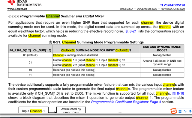

  • can you please let me know which application note you refer to for channel summing ?
  • Hello, about   channel summing, this is described at 5120 datasheet.Please look!
  • Hello,this is the related document.Please help look.Thank you!

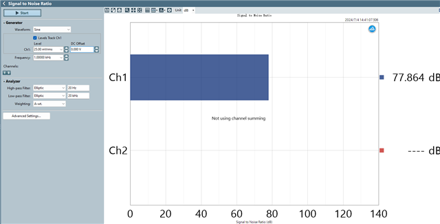

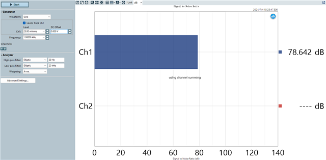

    Hello,the attachment is adc5120 init code.
    when close channel summing, we don't write data to register 0x6b, the snr is 77db.
    when open channel summing, we  write data 0x04 to register 0x6b, the snr is 78db.
    But according to datasheet, when open channel summing, the snr should be promoted by 3db,not only 1db.

  • Please disconnect R11 and R12 . Apply signal to one input of the ADC and evaluate performance of ADC with large and small signals applied to it. Please do not enable channel summation.
    Please let me know your results

    Hello,I want to user channel 2 as  analog input,but it seems that it has not work. please see the config files. and help check what the problem is .
    the background is i want to use channel summing to improve snr. but the result is not as expected. then i check the channel 1 and 2 seperately. the channel 1 works as expected. but the channel 2 doesn't work. SOS,thanks.
  • 1.Normally we do not suggest to directly connect the inputs of the  individial channels. I would suggest to connect the input signals to the 2 channels with seperate coupling capacitors. There are internal feedback loops that may get disturbed if we join inputs together.
    2. Check if Channel 1 and Channel 2 are individually giving a digital output.
    I note that your code either enables channel 1 or channel 2 .Please combine to make both work  at the same time.
    Additionally run command
       0x0B 0x00  This puts channel 1 data on left output slot0
       0x0C 0x01  This puts channel 2 data on left output slot 1 .
    3. After both channels run individually, try the summation command
  • thanks.
    I check the datasheet. in fact , after power on, TLV320ADC5120 0x0B is 0x00 and 0x0C is 0x01 initially . I don't change the register value.
    strange thing is when I only enable channel 2 , there is no data(seems doesn't work at all, even don't get any noise). but when I only enable channel 1, the data is as expected.
    thus i think may the reason cause  the summation value 6dB below.
    so, please help check ,if i what to only enable channel2. the schematic or the code may get something wrong?
    thanks again.
  • As I mention before Please do not connect the input pins of the 2 channels together. Connect signal with individual coupling capacitors to the the channel2  IN2P pin. Connect IN2M with capacitor to ground
    Please then check with an oscilloscope if the signal is actually present at the pin.
    In software enable only channel2
    Following this you can try with 0X0C at  0x00
