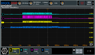

The TAS250 appears to have an auto mute function that we would like to implement however it does not seem to work as intended. In the code, pauses are included in some audio, and I would expect the chip to auto mute itself during those pauses. Once the chip is turned on, the speaker output remains high with noise until manually turned off, and I was not able to find more information on how the auto mute works. More information on this would be greatly appreciated!
I have included the boot sequence and relevant sequences for turning on and off the dac/spk. I2s and pins BCLK, WCLK, DIN are used.

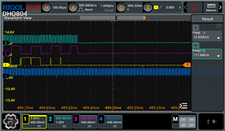

I have also included screenshots of the oscilloscope readings.

cyan = bclk
purple = wclk
yellow = din
blue = speaker
the audio played is a flat tone - a pause is included ~250ms before and ~400ms after
The start/stop code is run at the beginning and end of the sound file

  • Hi Duncan,
    As general practice, whenever input clocks (BCLK and WCLK) are halted, the device must be completely re-initialized.
    The auto=mute feature is related only to the DAC; however, Class-D must be controlled separately. (Independent of the comment above regarding clocks)
    -Ivan Salazar
