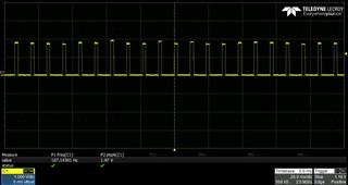

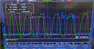

First attached screenshot corresponds to this configuration when the input signal is a 200 Hz sine wave :
Second attached screenshot is if we change this setting :
0x1E : 0x08; // OSCK Clock Divider=8
Could you please check our configuration and tell us if something is wrong ? or propose another setting for PCM5242 registers ?

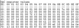

    # page 0 dump
    w 98 00 00
    w 98 7f 00
    w 98 00 00
    w 98 00 00
    w 98 00 00
    w 98 7f 00
    w 98 00 00
    w 98 03 00
    w 98 04 01
    w 98 05 11
    w 98 06 00
    w 98 07 00
    w 98 08 20
    w 98 09 00
    w 98 0a 00
    w 98 0b 01
    w 98 0c 7c
    w 98 0d 00
    w 98 0e 00
    w 98 0f 00
    w 98 10 00
    w 98 11 00
    w 98 12 00
    w 98 13 10
    w 98 14 00
    w 98 15 00
    w 98 16 00
    w 98 17 00
    w 98 18 00
    w 98 19 00
    w 98 1a 80
    w 98 1b 00
    w 98 1c 00
    w 98 1d 00
    w 98 1e 00
    w 98 1f 04
    w 98 20 00
    w 98 21 00
    w 98 22 00
    w 98 23 01
    w 98 24 00
    w 98 25 00
    w 98 26 f3
    w 98 27 04
    w 98 28 02
    w 98 29 00
    w 98 2a 11
    w 98 2b 01
    w 98 2c 00
    w 98 2d 00
    w 98 2e 00
    w 98 2f 00
    w 98 30 00
    w 98 31 00
    w 98 32 00
    w 98 33 00
    w 98 34 00
    w 98 35 00
    w 98 36 00
    w 98 37 00
    w 98 38 00
    w 98 39 00
    w 98 3a 00
    w 98 3b 00
    w 98 3c 00
    w 98 3d 30
    w 98 3e 30
    w 98 3f 22
    w 98 40 02
    w 98 41 07
    w 98 42 14
    w 98 43 05
    w 98 44 00
    w 98 45 00
    w 98 46 00
    w 98 47 00
    w 98 48 55
    w 98 49 00
    w 98 4a 00
    w 98 4b 00
    w 98 4c 00
    w 98 4d 00
    w 98 4e 00
    w 98 4f 00
    w 98 50 00
    w 98 51 00
    w 98 52 00
    w 98 53 00
    w 98 54 00
    w 98 55 07
    w 98 56 00
    w 98 57 00
    w 98 58 61
    w 98 59 11
    w 98 5a 00
    w 98 5b 53
    w 98 5c 00
    w 98 5d 40
    w 98 5e 00
    w 98 5f 00
    w 98 60 00
    w 98 61 04
    w 98 62 00
    w 98 63 00
    w 98 64 01
    w 98 65 01
    w 98 66 0f
    w 98 67 03
    w 98 68 01
    w 98 69 10
    w 98 6a ff
    w 98 6b d3
    w 98 6c 33
    w 98 6d 00
    w 98 6e 16
    w 98 6f 03
    w 98 70 01
    w 98 71 02
    w 98 72 03
    w 98 73 02
    w 98 74 01
    w 98 75 00
    w 98 76 85
    w 98 77 01
    w 98 78 00
    w 98 79 00
    w 98 7a 00
    w 98 7b 00
    w 98 7c 00
    w 98 7d 00
    w 98 7e 00
    w 98 7f 00

    # page 0 dump
    w 98 00 00
    w 98 7f 00
    w 98 00 00
    w 98 00 00
    w 98 00 00
    w 98 7f 00
    w 98 00 00
    w 98 03 00
    w 98 04 01
    w 98 05 11
    w 98 06 00
    w 98 07 00
    w 98 08 20
    w 98 09 00
    w 98 0a 00
    w 98 0b 01
    w 98 0c 7c
    w 98 0d 00
    w 98 0e 00
    w 98 0f 00
    w 98 10 00
    w 98 11 00
    w 98 12 00
    w 98 13 10
    w 98 14 00
    w 98 15 00
    w 98 16 00
    w 98 17 00
    w 98 18 00
    w 98 19 00
    w 98 1a 80
    w 98 1b 00
    w 98 1c 00
    w 98 1d 00
    w 98 1e 00
    w 98 1f 04
    w 98 20 00
    w 98 21 00
    w 98 22 00
    w 98 23 01
    w 98 24 00
    w 98 25 00
    w 98 26 f3
    w 98 27 04
    w 98 28 02
    w 98 29 00
    w 98 2a 11
    w 98 2b 01
    w 98 2c 00
    w 98 2d 00
    w 98 2e 00
    w 98 2f 00
    w 98 30 00
    w 98 31 00
    w 98 32 00
    w 98 33 00
    w 98 34 00
    w 98 35 00
    w 98 36 00
    w 98 37 00
    w 98 38 00
    w 98 39 00
    w 98 3a 00
    w 98 3b 00
    w 98 3c 00
    w 98 3d 30
    w 98 3e 30
    w 98 3f 22

  • HI Arash,
    VNEG and SCLK are ok.
    Below, screen capture of signals. yellow is LRCLK, pink is bit clock, blue is data, green is SCLK.

    The register dump is here:
    I’m not sure about the IDAC settings. The output signal looks even worse:
    This is the output for a 1kHz sinus Frowning2
