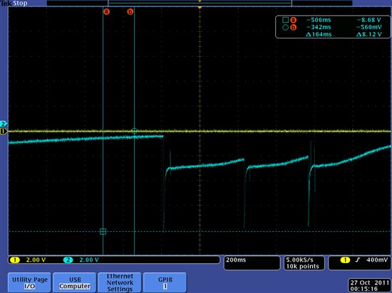

    I’m also sending some screenshots of the voltage transients recorded at each input of the PGA2500 when each input is shorted to ground while the 48V phantom supply is activated. As you can see, the transients can reach -8 volts in some instances, which is beyond the specified maximum input.
    We have applied (>200) multiple shorts to the inputs of the amps and have not experienced any failures or degradation of performance in our testing so far.

    When the PGA2500 was in development, the schottky diode protection scheme was a typical protection scheme used at the time.  There may be other protection schemes that may be used, however,  the user must ensure that the maximum allowed absolute ratings for the PGA2500 device inputs and supplies are not exceeded.  The inputs must not exceed +/-0.3V above the VA supply as specified on the datasheet.
    Attached is an article available on the web on different protection schemes that you may find helpful (Bortoni and Kirkwood:  The 48V Phantom Menace Returns).  On figure 17, the authors of the article show a protection scheme using 4x 1N4004GP diodes.  A possible scheme could be to use the 4x 1N4004GP protection diodes with 47Ohm series resistors.
