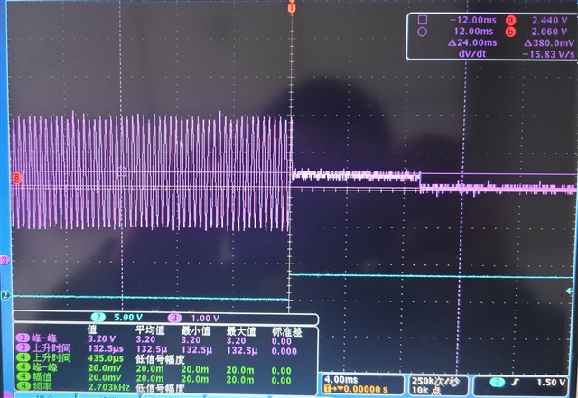

I met a problem with PCM1754, its output voltage stepped after has been muted for 9ms. This kind of step change of output voltage will result problem with following power amplifier. It has been confirmed the I2S communication has been stopped before and after mute signal. What is the reason of this output voltage step? below is the waveform scoped at VOUT pin.
In the picture, channel 2 (blue) is MUTE, channel 3 (red) is VOUT. In which you can find right after MUTE issued, the VOUT level is about 2.5V, this is expected. However, the problem is about 9ms after MUTE, the VOUT level stepped from 2.5V to 2.1V. What is the reason of this stepping? how to avoid it?

    I am sorry, some information I previously said is not correct. I have engineer done some further test.
    The fact is the I2S signal is not shut off when MUTE is issued. The cause of step is clear. The system shut off I2S signal 9ms after MUTE, and before MUTE signal system has write PCM1754 to 2.5V out. The question is why 0.4V step occurred when shutting off I2S signal though it has been muted?
    Also I have engineer done another test: send MUTE signal when the DAC is set to other value than 2.5V, wait for 9ms delay, and then shut off I2S. The result is VOUT level after mute (and I2S is still on) is correctly 2.5V, while with I2S shutting off (in MUTE status), a 0.4V step occurred on VOUT. The step can be steadily repeat, but the step may be +0.4V or -0.4V.

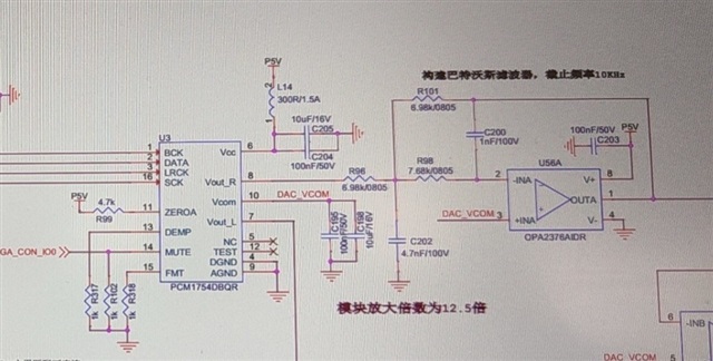

    This 0.4V step is not allowed, what should be done to avoid it? Below I attached the newly tested waveform and the schematic.

    1) Which attachement to the DAC do you meant? The op amp is used for LPF and it has been checked working properly.
    2) The two wavefrom was get from same part. The step is not same each time. Some time it step up 0.4V, some other times it step down 0.4V. The VCOM is connected to noninverting input of op amp, which is high impedance, no any load effect to VCOM. There is no problem with this kind of connection. The app note schematics you mentioned is incorrect.

  • John, by removing attachment of the DAC , I meant remove the active filter that you have  attached to the DAC, then just add a simple passive LPF. For the second test, with the original active filter, I wanted to see if you connect the VINP of the amp to GND,  you would see  any difference, but since you  confirmed VCOM is not changing at all, this test probably  will not yield any additional data point.

    Further test was done, here is the result:
    In this scoped waveform you can find, VOUTL muted to 2.5V as expected, while it stepped 0.4V down as I2S signal is shutting off. And throughout full process the VCOM output (yellow) is stably at 2.5V, no any.
    Another test was done keeping I2S working and make MUTE=H (connect to VCC directly). At this condition VOUTL is muted at 2.5V continuously. And then we try to short I2S signal one by one to GND. The result is VOUT keeps unchanged when we short SCK, BCK, and DATA input to GND. 0.4V step occurred once we short LRCK to GND. The direction of stepping is random but always 0.4V, sometimes +0.4V, some others -0.4V. The effect on VOUTR is same, but step direction always opposite, +0.4V step occurred on R channel while -0.4V step on L channel, and vice versa. Seems like there is Quantum Entanglement effect Slight smile
