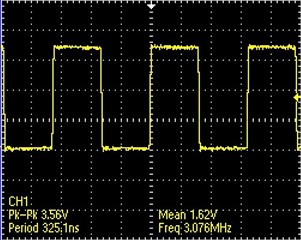

    Below are the bclk and wclk captures
    bclk:
    wclk:
  • Hi Sakshi,
    Thanks, the clocks seem OK.
    Let's double check on the slot configuration and see if that helps.
    -Ivan Salazar
    Applications Engineer

  • Hi Guy
    Would you be so kind to measure the bck and WS clk with scope during playbck?
    It seemed no bck and WS clk output from the McASP.
    Below are the scope captures of wclk and bclk while playback.
    bclk:
    wclk:
    when playback stops, clock also stops.
