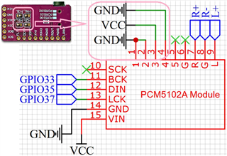

I know, that for propper work of this board I should connect solder points H/L on back of module.
I want to make 1L, 2L, 3H, 4L.
Can I use instead of solder joints pins 1-4 to connect with GND/VIN (Low, High) as seen on picture (pink)?
Would this work?
Is there something I need to care about or any potential issue with this solution?
Thank you
