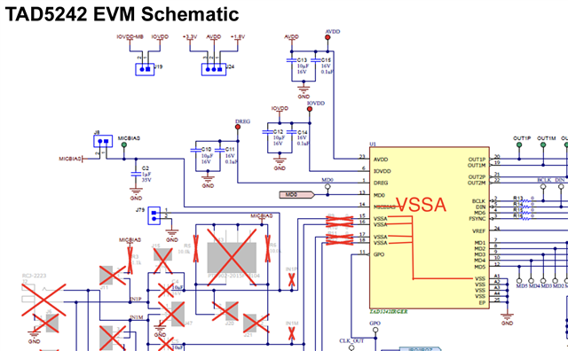

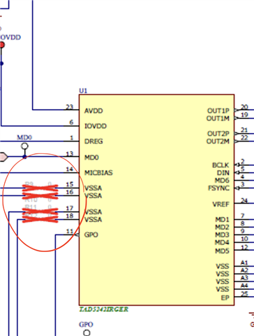

TAD5242: Error in EVM board schematics?
Part Number: TAD5242
According to TAD5242 DS:
1. All AVSS pins must me connected to ground
2. Pin 14 is AVSS
But according to EVM board schematics, https://www.ti.com/lit/pdf/SLAU904
Pin 14 is connected to capacitance and named MICBIAS instead of AVSS, and all AVSS pins are all left unconnected.
What is correct?
