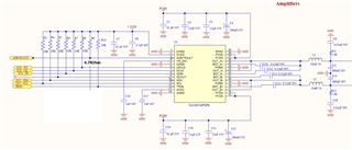

    I attached here my circuit for TAS5805M in case if I had any wrong.

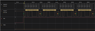

    I experienced the same thing for both TAS5828M and TAS5808M devices, I need both DVDD and PVDD to be ON in order for me to enter the setup for read/write registers.
    Case#1: No PVDD Kept Getting Nak from TAS5805M with 4.7KOhms Pull up to DVDD to set address 0x2C
    Case#2: Turn On PVDD successfully getting data from Register 0x01 0x02, and 0x03 etc...

    as tas5805’s vr_dig also needs pvdd.
    if there is no pvdd, the digital power supply cannot work.
    you need pvdd to read/write register.
    thanks

  • Hi Chad,
    The TAS5828M is a much higher power device compared to the TAS5805M and can handle more current. I did see on the schematic that the current rating on the inductors is low (3.8A). The TAS5828M can output up to 8A typ per channel of current, so the inductors could be saturating or having large ripple currents as the inductance falls with large current. This can also be made worse by layout imperfections.
    The two devices also have different register maps so an I2C script for one will be incompatible with the other.
