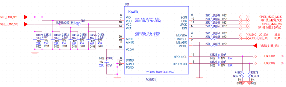

PCM1774: Request for review of schematic of PCM1774
Part Number: PCM1774
Hi, TI expert
A customer has requested a schematic review of the PCM1774.
- Application: Industrial and vehicle driving record type AI BOX.
Please review whether there are any parts to be modified or added.
Thank you.

  • Hi, Jeff McPherson
    In addition, please confirm one more thing.
    Regarding the CAPACITOR value of the POWER SUPPLY PIN, I applied it by referring to the EVM board reference.
    Since it is applied relatively simply in the data sheet, I would like to reduce the CAPACITOR if possible because the space is narrow.

  • Hello Grady,
    Here are few recommendations:
    1- You don't need the series 22 ohm resistor for all digital pins, for I2S pins keep them
    2- For I2C pins use pull up resistors ( you can refer to this  application note  for more information: SLVA704–June 2015 Understanding the I2C Bus)
    3- For MODE pin remove 22-ohm , you can use a pull down/up resistor based on your need.
    4- The  capacitors you have at the moment are preferable and I would use them but at the end of the day you can always differ from recommendation and still the part would work fine. So if you really have to reduce them, then that is what needs to be done.

  • Hi, Arash
    Thank for response.
    Customer have additional questions.
    Q1) 1- You don't need the series 22 ohm resistor for all digital pins, for I2S pins keep them
    → You said 22ohm is not necessary, if I use it, will it be a problem?
    Q2) Regarding the VDD (DIGITAL CORE) voltage, there is no explanation in the spec sheet about how the characteristics are different at 1.8V and 3.3V.
    Please explain this part.
    Please check. Thank you.
  • Hi Grady,
    The  22 to 100 Ohm resistors are used to avoid reflection and ringing on I2S  lines.  We do not use those resistors for other pins .  Removing/shorting an unnecessary component should be easy and i suggest to do so even do I don't think it will be an issue.
    Whatever is provided in the datasheet,  is the data set that we have available. If there was a change/shift  in the characteristic for 1.8V vs 3.3V,  it would have been mentioned in datasheet and plots and numbers would have been provided.
