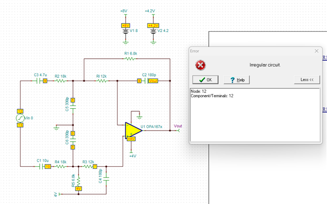

I am trying to simulate the AC analysis via TINA. But met the issue. How can I use the differential signal as input?

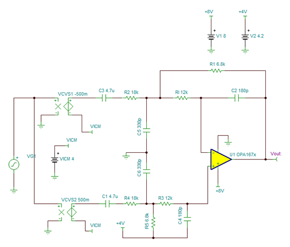

Attached is the revised simulation file. I used two voltage controlled voltage sources to generate the fully-differential input signal. You can set the VICM supply to the required input common-mode voltage.
See attached.
Please let me know if you have questions.

Hi Luis,
Thank you. May you let me know how you simulate the VG1 and Vout?
In addition, how you determine the VG1 frequency? Thank you.

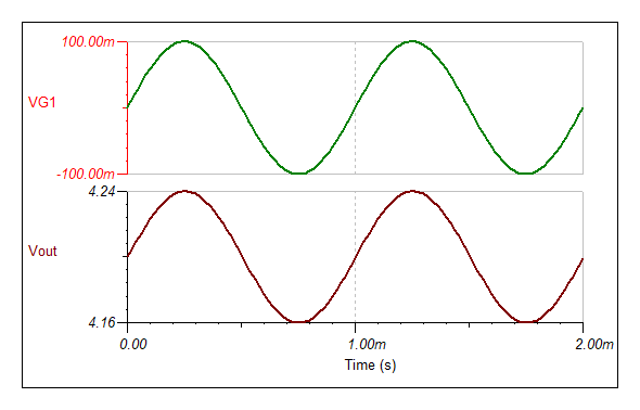

Hi Roy,

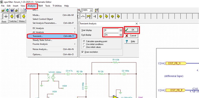

In this case, I performed a transient simulation using a 1kHz source; but you will need to change the frequency per your signal requirements; I only copied your circuit. If you need to determine the small-signal BW frequency response, you can perform an AC small-analysis.
You can perform a transient simulation from the top menu, as shown below:
