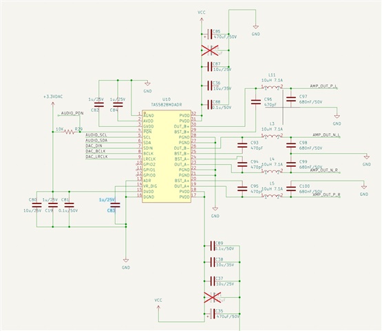

  • Hi Jesse, thanks for your review and response. Please see the attached schematic
  • hi,
    your circuit seems no problem. can you tell me your pvdd and load resistance?
    also, can you remove the inductor and check whether it can be initialize normally?
    have you tried other chips, is that possible this chip having any problem?
    thanks
    jesse
  • Hi Jesse,
    PVDD is 12V, and we are driving 2x 4ohm speakers, 20 watt rating. Because of the design of the circuit it is not possible to desolder the inductor. But we have tested without the speakers attached and have the same result. All boards of this schematic implementation have this issue. For reference, we are using 4.1 Amp 10 mH inductors.
    Please let me know how we can debug further.
    Thanks.

  • hi,
    base on your situation, let me summarize my analysis. maybe we have some miss.
    1.origianlly, as your code is very obviously different with how we dumped from ppc3, so i suspect your initialization code having problem. especially, we don't recommend manually config the i2s setting as we have auto detect in dsp, it will help make customer easy to use with our amp. manually change the setting always may miss some configuration. that's why i share you another script for initialization.
    2.as you read the register, find the oc happen during start-up.
    this is usually because your inductor isat not large enough as the startup current usually is large. this point you can check the "inductor selection" section in our DS for double confirming.
    but as your sch show you have 7.1A Isat inductor be used, this spec is good enough, also, your pvdd is not that large, so this seems also impossible.
    3.as you find the i2s seems having problem, but usually, if i2s clk having problem, the fault report register will report clk fault, you can check 0x70-73, except oc, no other fault be reported. so the clk fault seems haven't happen.
    but because your sch shows no obvious risk to let oc happen, so it maybe better to check the i2s to double confirm what kind of fault will happen.
    thanks
