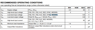

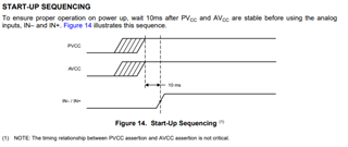

    Looking at the schematic, I see the IN- cfg is loaded for transient noise decoupling which is okay, but voltage dividing a 2Vdc source into that pin seems like a problem. The DS recommends this pin should have a 3Vdc source going into the IN- pin. Right now, it seems the voltage going into this pin is outside the DS recommended operating mode. Also I strongly advice following the startup sequence in your application. I have attached images below for guide.
    It is not clear what you have on the FS pin cfg, the max recommended voltage is 0.8V and there is a scheme for desired oscillation frequencies. I have attached images below.
    It is not clear what the operating PVCC voltage but if it is higher than the recommended FS pin voltage required, the device is not operating within the recommended conditions.
    To have a functional DRV595, I would start from fixing the bugs I have mentioned above.

  • Hey Ore, thanks for reviewing the schematic. Just to mention it again: We have been using this design in hunderts of products before without a problem. We always use the 0,4V Ref on IN- and 0...0,8V on IN+. Our power supply voltage is 24V. We always have the 100k series resistor on FS pins. I measured it the first time now and it results on 18V on the pins. I installed a pull down resistor to make the pin level 0.5V but it does not help. By the way, I copied this design from your evaluation board, and there are no pull down resistors either. So that is obviously not the problem. The only thing I could imagine is the timing from PVCC and IN+/IN-. Meeting that requirement is very hard to achive in a design. We encountered some problems in the past with the starting of the device, sometimes it catches the wrong gain config from the resistor devider. You can only resolve that problem by powering down the device and starting it again. So we installed a mosfet relais in the PVCC line to switch the device completely off and on again, but the IN+/IN- stays powered all the time.
    we will make some further tests with the IN+/IN- input timing and levels now.... keep you updated.

  • Okay Christopher. I would look through the extra info provided and while you investigate, please provide .pdf format. It is hard to zoom in on the image.
    I would like to add, if the IC is not responding to the correct configuration after operating in a different/non-ideal way outside the recommended conditions, it may be hard to get the IC working again. The IC should always operate with recommended conditions. I strongly advise following the start-up sequence, if some conditions aren't met, the IC could experience some reverse bias current flows that it is not expecting.
