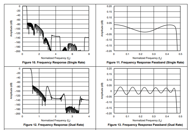

    Single vs dual rate mode affect the passband of the device with the digital filters, shown in this screenshot of the ADC filters (section 8.15.1):
    Single rate mode puts the device into 128x OSR operation at the ADC/DAC modulator clock, which will ensure that the filters work as intended with the most amount of clock cycles needed for operation. Dual rate mode puts the device into 64x OSR, so the filters and internal DSP systems would have less cycles to work with, but would be potentially less power needed as well. This mode would be better suited for systems where the system clock does not get to 128x the sampling rate, or for sampling rates above 48k. In your scenario, 256x input ratio should be fine for a low sampling rate and is still a higher input clock than 128x OSR so there will be a divider internally to get to 128 OSR at the mod clock.
