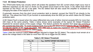

    1.this is an analog device, it cannot be disabled.
    2.i checked some similar AIN amps, they seem all have this feature.
    3.how low does your input signal it is, if it is less than 2hz, then there might no way to solve it. if it is above 2hz, i check below section in the DS, it might somehow help you.

    I'm not sure how pulling SD pin low would help in my case - wouldn't it basically disable the amplifier?
    I also have a question about how this feature is implemented. According to the table that Jesse attached, this mechanism is triggered by the output offset voltage, but the IC has access only to the switching node (unfiltered output).
    Any chance that what triggers the protection is actually input offset voltage? If yes, then would introducing a short negative pulse (basically bringing input to 0 for a few dozens/hundreds of ns) help to "cheat" it?
  • hi
    the trigger is base on the dc offset happen at output.
    if the differential input originally exist small dc bias, which be amplified at the output. this can lead to dc detect be triggered.
    it is not detect the signal at the speaker. it detect the output before LC filter. if the duty cycle is too large which might trigger the dc fault.

    low frequency signal naturally has one side large duty cycle, also because the frequency is low, the duty cycle sustain time is also longer, also low frequency signal is also get more close to DC voltage. which make the trigger easy to happen.
    "cheating" mechanism might work. i just know some customer using this kind of method for reducing pop noise.
    but as i said before, tpa31xx is for processing audio signal which mean 20hz-20khz is what it be designed for.
    out of this range, TI cannot ensure its behavior.
