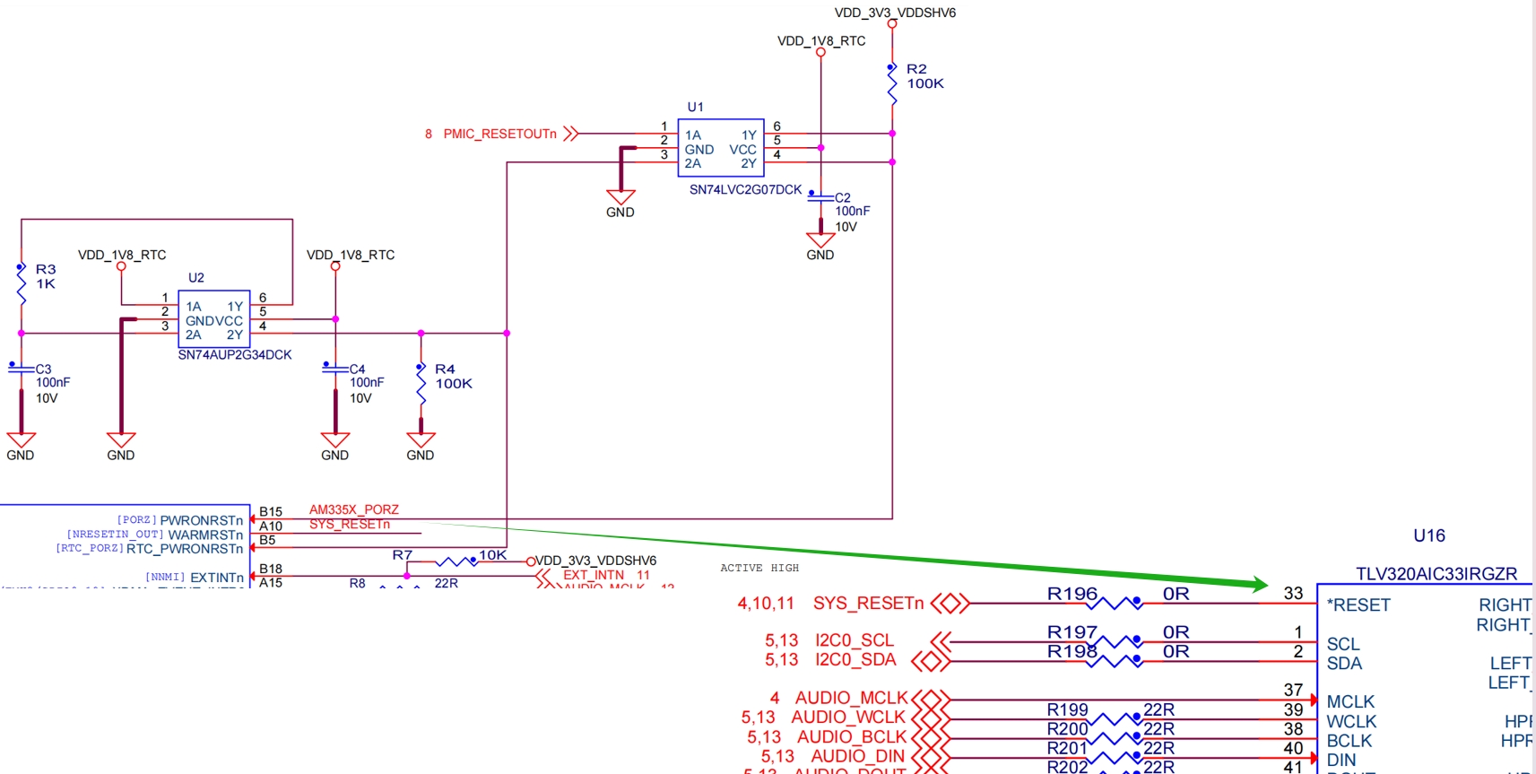

    As shown in the figure below, the RESET pin of the AIC3x chip is connected to the NRESETIN_OUT/WARMRSTn pin of the AM335x via a 0 ohm resistor (R196).
    We plan to disconnect R196 and use other GPIO to control the RESET pin of AIC3x.
    Now there are the following questions:
    1. Is it possible to generate a reset output signal by operating the NRESETIN_OUT/WARMRSTn pin of AM335x through software ?
    2. If we use GPIO to control the RESET pin of AIC3x for hard reset, is it allowed to hard reset the audio chip multiple times a day ? If we perform a hard reset before each audio task, is there an unknown risk (reset freq: > 40 times/day) ?
    I'm not sure about the AM335x operation but the reset signal just needs to be driven low for 10ns or longer to perform the hardware reset. It should be fine to reset multiple times per day, and you are supposed to hardware reset after power up of the device anyway. I think that we should keep trying to figure out what is causing the audio failure as well since hard resetting the chip so often seems like overkill.
