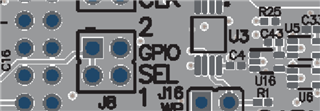

    I got the new TAS2563 EVM from TI. Thank you for your help!
    However, I see that the jumper defaults on the new EVM are different from what we discussed last time (pictured below). What kind of setup should I follow?
    Thanks.
  • Hey Paul,
    If you're operating both TAS2563EVM units on the board simultaneously, make sure all power lines for units 1 and 2 are connected. This includes vdd, iovdd and vbat. GPIO select should be connected horizontally and not vertically. If two units are used at once, make sure the ADDR select are different for the two. The default ADDR for TAS2563 is x98.
    If only one unit on the EVM is in use, disconnect the power lines from the other unit, and you can make the ADDR selection any of the 4 values.
