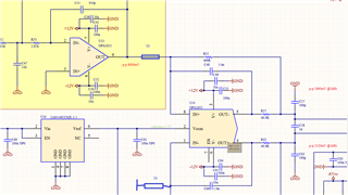

Hello !
I get different p-p amplitude from the outputs.(check the red remarks 1860 vs 2120mV)
I have checked following:
1) checked and doublechecked all resistors - nope
2) tried to add unity buffer to filter circuit output - nope
3) changed gnd-signal inputs in OPA1632 - outputs also switched places as they supposed to do :) along with the unbalance
4) tried Vcom input - open, GND and Vref - nope, no effect to output gain balance
5) removed the 1632 capacitors - nope
5) disconnected the AD converter from OPA1632 - no effect
Is there some connection to previous stage opamp output impedance ? The error is too big IMHO for that. Im going crazy, tried almost everything. At least, good to know that I have not mistaken in prototype assembly.
Please share experience !
Also, is the imbalance problem at all (exept that AD input range is a bit reduced) ?
