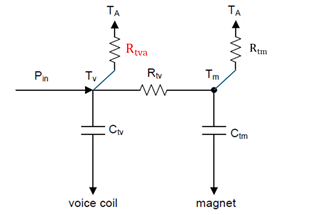

  • Hi Fumiya,
    • The difference between Rtv and Rtva is:
      • Rtv is thermal resistance for the dissipation going from voice coil to magnet (this then goes from magnet to ambient, Rtm).
      • Rtva is the thermal resistance for the dissipation going directly from voice coil to ambient.
    -Ivan Salazar

    (2) Regarding Rtva, I have summarized my understanding in the first attached photo. (This is a modified version of Figure 12 in "SmartPA Speaker Protection Algorithm")
    Is this understanding correct?

    Edit: you're correct on Rtva.
