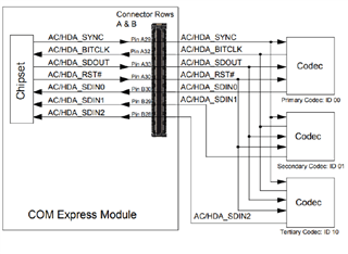

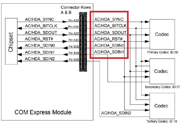

    The TAS2770 amplifier was chosen because it can be used as a codec to work with the HDA bus
    which is on the COMExpress bus as below.
     It is possible to use several codecs
     The platform provider suggests a link to a similar codec
    https://github.com/torvalds/linux/blob/master/sound/pci/hda/tas2781_hda_i2c.c

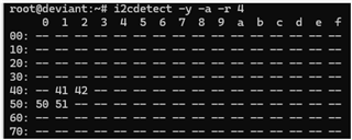

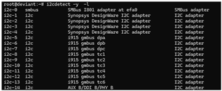

    The platform sees such i2c ports
    The TAS2770 stereo amplifier is seen on i2c addresses 41 and 42.
    51 and 52 are other sensors.
    Example reading of amplifier registers with address 41

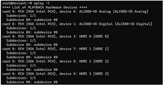

    Linux shows such devices for aplay –l command:
    Is there any other info you need?

  • Hi Guy
    Your system is the HDA architecture, First, you must ask platform vendor how to add tas2770 into UEFI or BIOS.
    The attachment is the UEFI setting for tas2781. hope it is useful for you.
    After that you can set the tas2781_hda_i2c.c as the sample code for tas2770.
    The tas2770 driver from git.ti.com can't work on your platform, it is not for HDA architecture.

  • Hi Guy
    I have to point out that two pieces of TAS2770s can't be directly connected to platform.
    While TAS2770 only supports I2S/TDM instead of HDA. TAS2770 does not support such connection.
    Unless you must connect I2S input to HD-A codec’s I2S bridge. In such scenario we can re-use 2781 driver with minor modifications as needed.
    We have much HDA driver experience focused on PC products, all of our amplifiers in these products are connected with Realtek codec, and realtek codec directly connected to the HDA.
    One more thing, do you need IV data for speaker protection or echo reference signal for AEC?
  • I keep explaining that I chose the TAS2770 element, since it has very good documentation, and seems to be the best suited for our purpose.
    You can connect not only two but even eight to the platform, as shown in the TAS2770EVM-Stereo development board documentation.
    The original question was - how to correct the driver to support the stereo version and not the mono version.
    At the moment, the question can be expanded - how to correct the driver to support all eight channels instead of the mono version.
    However, I gave up on the original question because I encountered difficulties in starting the driver, even the mono version.
    There is no justification for associating the cooperation of TAS2770 with REALTEK, because TAS2770 is supposed to replace REALTEK.
    The programs in the introduction declare "ALSA SoC" and therefore support HDA as below.

  • Our TAS2781 HDA driver can support multiple pieces in one device. We applied the regbin arhitecture into the driver.
    All the register settings are saved into a bin file. You can define the pieces of TAS2770 in the bin file.
    Regbin tool link toolset « regbin - tas2781-linux-drivers/tas2781-linux-driver - Unnamed repository; edit this file 'description' to name the repository.
    This tool was developed right for you.
    One more thing, I have to highlight again that TAS2770 only support I2S/TDM, can't be not connected to HDA bus dirreclty, or it can't work.

  • I have not asked, and I am not asking, about the hardware connection.
    The TAS2770 is connected to the HDA bus, and you can read and write the TAS2770 registers using the Linux i2get and i2cset commands, as previously presented.
    The suggestion to use a TAS2781 driver for the TAS2770 was rejected earlier on since I'm familiar with both components and know that I2C addresses are different.
    Now, the information that the TAS2781 driver can be configured for other components is new and worth trying.
    While the documentation for the TAS2770 itself, along with the PPC3 tools and the TAS2770EVM-Stereo development board, is very good and allowed me to easily build and test the amplifier in a short time, support for implementing a Linux driver is practically nonexistent, even though the TAS2770 is very attractive for industrial applications.
