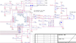

    I attached my schematic.
    Is this correct?
    Your schematic looks alright, my main note is to keep DGND and AGND separated - I see a connection from IOVSS and DVSS to your AGND line, make sure those are separated to DGND. But, the main issue with this is potential for noise, not the headphone low power issue. Also, you may want to make sure the power up sequence is done correctly, with speaker supplies, digital supplies, then analog supplies. I think the speaker supplies would be for both SPK and HP outs, and then the IOVDD/DVDD, then AVDD. You could try to keep the HP VDD with the analog supplies as well, so powered up after digital supplies. I see that your IOVDD is 3.3V, can you make sure that it is powered separately from your analog 3.3V supplies?
    Where are you measuring the HPL and HPR output? Maybe your filter circuit or jack connection is introducing some problem? Are you able to measure a line output from the headphone pins, or a speaker output from SPL/SPR?
    Let me know about this.
    Mir
