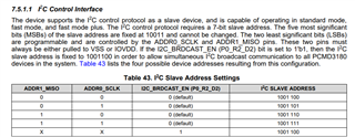

    Drivers are usually located on a path that your computer searches for, for compatibility with the registers of the device and how they would map to volume control or other parameters, for example. It would depend on the end device where the driver files need to be installed. Unless you need a lot of drivers for your end application, if you are a beginner I would recommend trying to communicate with the device over I2C first before you worry about drivers. Check the address 0x4c if MISO and SCLK are low.

    Yes, the driver code is for the master device (a Linux computer or MCU of some kind) to communicate over I2C and I2S with the codec to send audio between the two with ALSA. The codec is always the I2C slave or target of the MCU, with a driver or without. Since the drivers are not written for a non-Linux system, I believe you will have more success communicating with the device with configuring the I2C manually with register settings from your MCU, and then using the ASI on your LPC5516 to send clocks to the audio converter and receive the audio data out.
